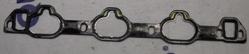

Message The gasket you removed from your car is typically for 90-93 (and some early production 94). The gasket from the kit is also correct and will work fine for your motor.
The 95 & 96 cars' gaskets are made out of the same thin stamped material BUT they are shapped a bit differently - the notch that stick up from the 3 openings is squared off to match the heads 95-96 heads.
All dates mentioned above apply to TT's.
95+ gasket laying on top of a 90-93 gasket:
